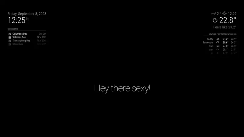

Position ​
The locations can be found in the following screenshot by their color:
  • top_bar and bottom_bar are light gray
  • top_left and bottom_left are red
  • top_center and bottom_center are blue
  • top_right and bottom_right are green
  • upper_third is yellow
  • middle_center is cyan
  • lower_third is magenta
Screenshot of Regions
Missing are the fullscreen_below and fullscreen_above as those cover the whole screen, one under everything else and the other above.
All these regions will resize as needed.
